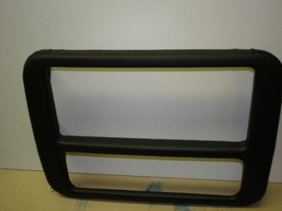

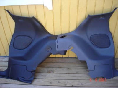

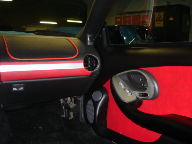

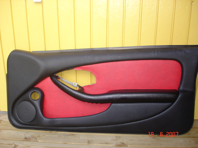

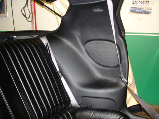

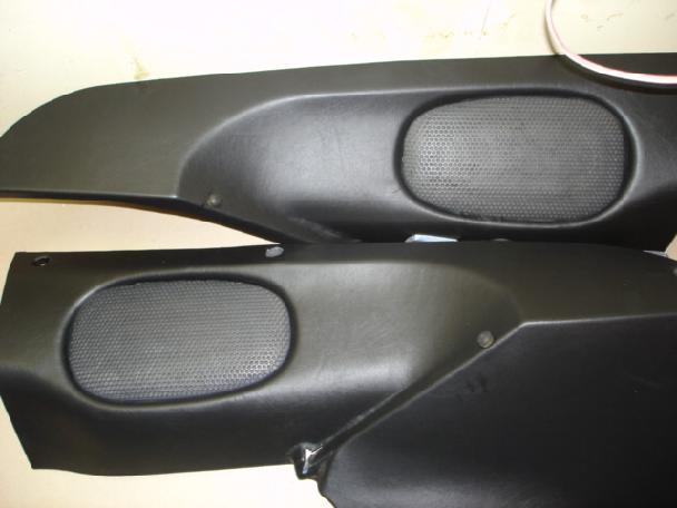

One part I’m really don’t like when I comes to F-body is the interior.
How in the hell can you, as a manufacturer, choose to use so simple and so ugly plastic interior in a car as Pontiac did for the Firebird & Chevy for the Camaro?

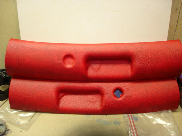

That is why I decided to wrap my ugly grey plastic into some more fancy black leather imitation.
For now I’m waiting on my new black carpet, then I can start to get things together and be ready for 2008.
:ok:

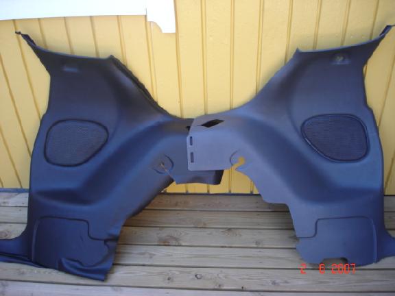

File comment: Comparing one panel wrapped and one in ugly grey plastic

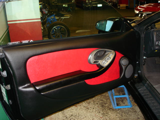

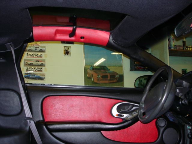

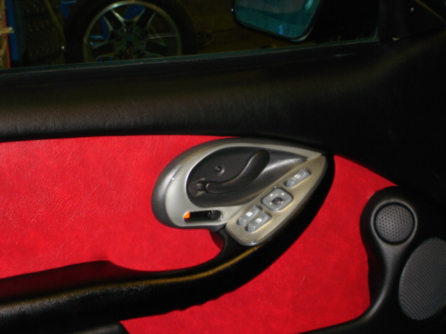

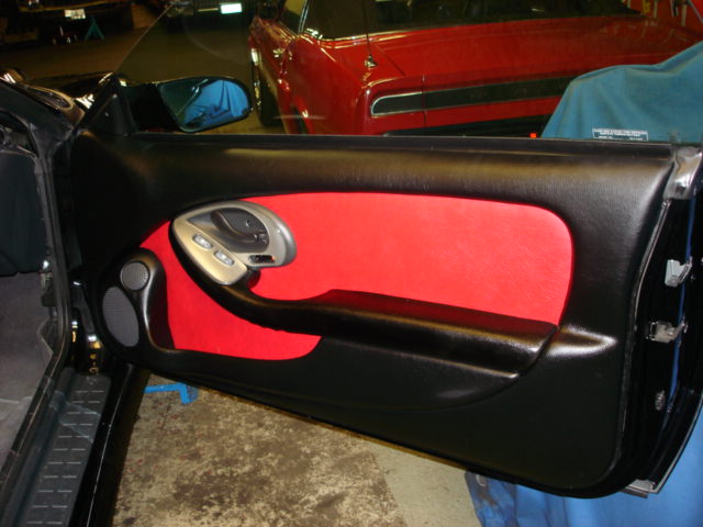

Some more pics

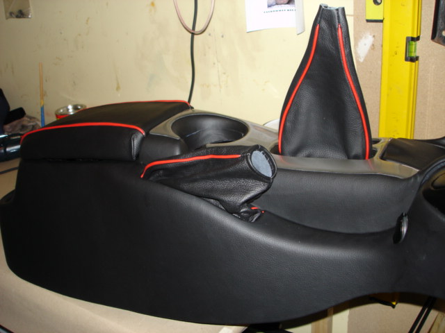

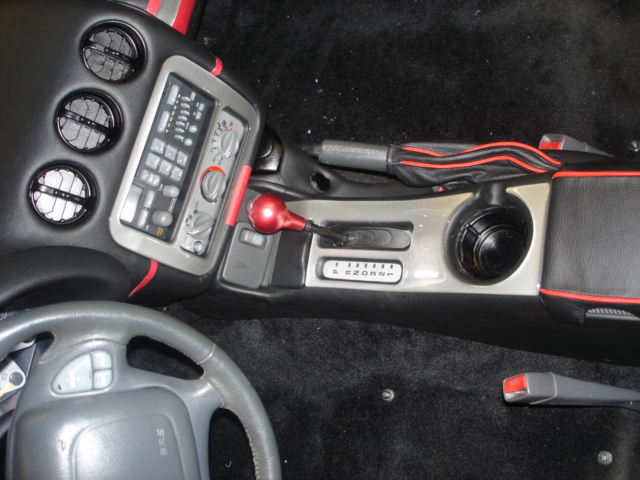

And some more. :D
File comment: Macewens

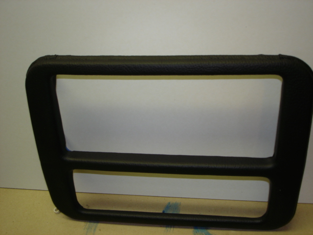

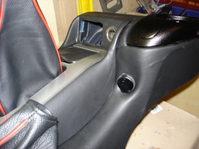

Thank you,
I’m buying all material as vinyl and glue from this shop located in the south part of Sweden, helsingborg.
http://www.topntrim.nu/
The vinyl I’m using is a super stretch kind. With a little help from a heat gun you can make magic!! Glue is 3M scotch-weld contact adhesive blue water dispersion 30
Consistency is almost like water. You need to wait a couple of hour after you have prepared the two surface you want to attach.
Tools:
Heat gun (hair-dryer), screw clamp at least 2 , sandpaper, cutting pliers, scalpel or a really sharp knife, something to clean the panel. Glue, 3M fastbond &spray 74 (simply the best.)
Preparation:
Use sandpaper to rough the panel, and then clean it.
Material:
Super stretch vinyl the black one & normal vinyl for the red part. Advantage of using vinyl instead of real leather is that vinyl is much more flexible, it is more easy to form, stretch and work with, the look is the same minus the nice real leather smell L
Cut much larger piece of the vinyl than the actually panel is, just to be on the safety side. I would say 10” more in every direction.
Decide where you want to begin, I prefer to not do the whole panel at once instead I start with one side and work me around.
Apply 3M-fastbond glue to both surfaces. Wait for at least 4-5 hour before you start the assembling. Lay down the vinyl over the panel where you have covered it with glue. Heat(caution do not over heat) the vinyl up; it will be soft and very stretchy. Stretch out the vinyl over the panel
And work it out by pressing vinyl by hand to the panel. Be very patient and work slowly. You need to work out every hole and deep areas to get the texture. When the front side is completed you need to wrap the vinyl on the opposite side of the panel and fix it. I used the spray glue 3M 74 for this occasion. What you need to have all time is glue & heat.

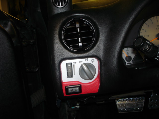

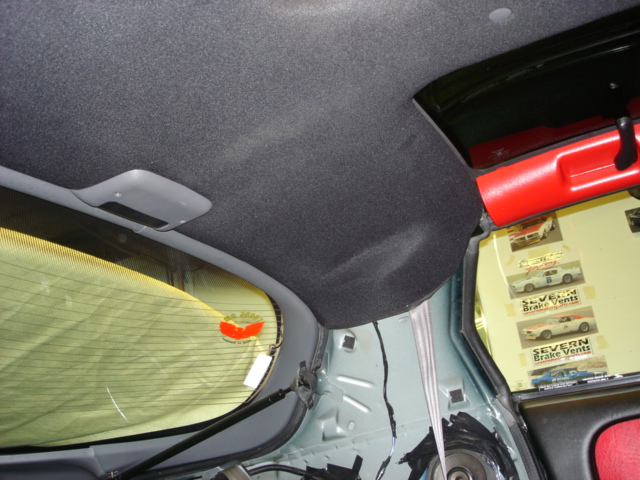

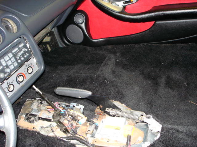

Some update pics on the progress.
File comment: New carpet in place-black one.
File comment: New headliner in place-black

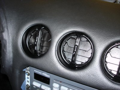

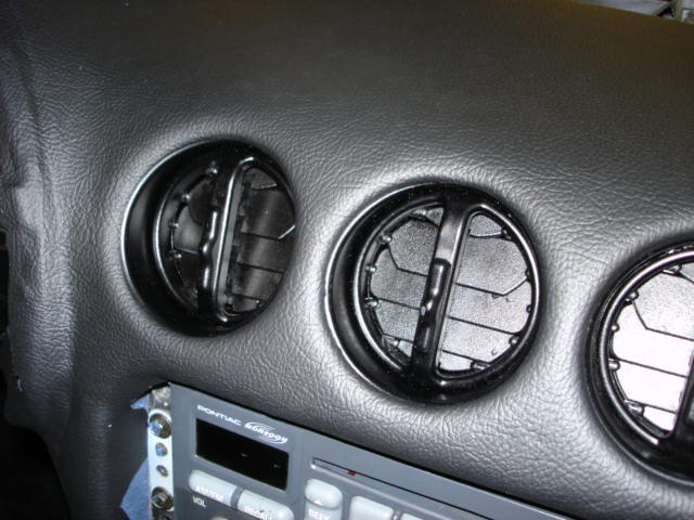

File comment: Working on the dash board.

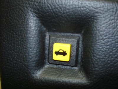

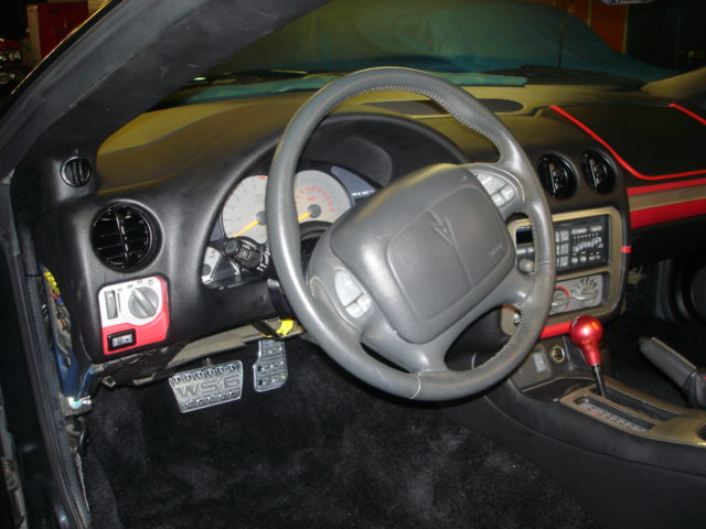

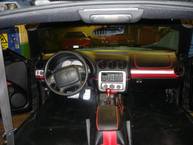

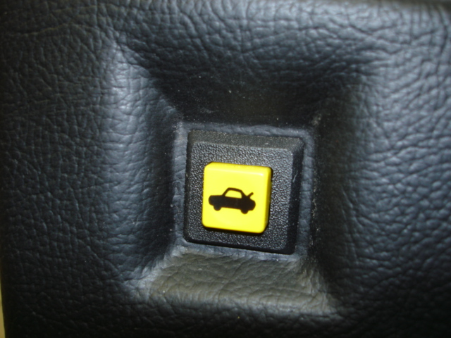

My dash is now completed.

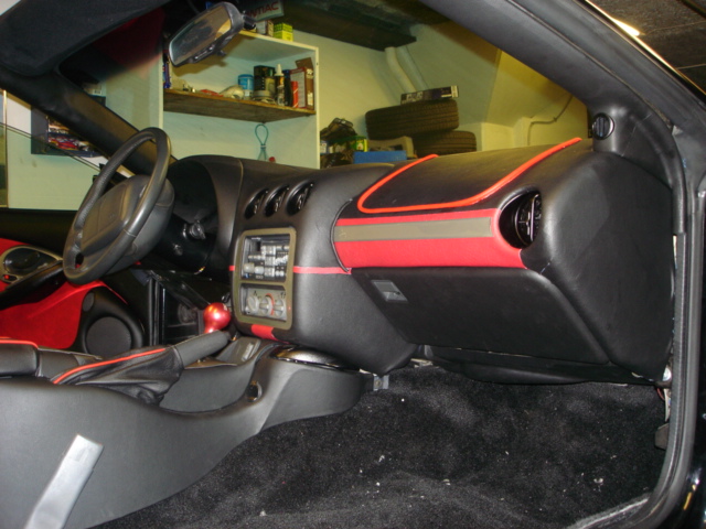

some more.
