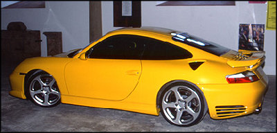

if a 911 has this "inlet" above the rear wheels is that a special model ? eg special engine ?
(not neccesary including the louvres in the rearspoiler below)
thanks, Joeri

Hi Joeri,
what you see above is a 911 Turbo.
The air inlet is for the intercooler (to cool down the compressed charge air). Cooling air is sucked in in front of the wheels, ducted over the wheels to the intercoolers (behind the wheels) and exit out the slits on the lower bumper. The reason why I say "sucked" is that air evacuation depends largely on the low pressure area around the air exit slits.
Air supply for the combustion process is central on top of the spoiler.
RUF uses narrow-bodied cars for his Turbo conversion and does not have the space to duct the air over the rear wheels. He cuts openings above/behind the wheels for his intercooler intakes.

2slow wrote: RUF uses narrow-bodied cars for his Turbo conversion and does not have the space to duct the air over the rear wheels. He cuts openings above/behind the wheels for his intercooler intakes. [/img]
I recently saw Ruf on TV and he said that the reason (also) was to avoid the rear brakes area, so not heating up the air...(?)

I don't quite understand what you are saying (or what you understood about what Ruf was saying).
The 911 rear brakes are cooled by air scooped under the car, directed into the centre if the disks and sucked out through the wheel spokes (due to the low pressure area caused by air accelerated around the rear wheel-arches).
On a narrow body, you have no option but to do what Ruf did to get air to the intercoolers. However, it is not a very good place to fetch air (I have spent untold hours in the Porsche windtunnel optimizing the 997 bodyshape, so I think I have a good knowledge of the vehicle's shape).
Although Alois Ruf is a good friend of mine, I have to say that he is slightly "adventurous" when it comes to aerodynamics (stick some wool tufts on the body and blast down the Autobahn).

2slow wrote: intercoolers. However, it is not a very good place to fetch air (I have spent untold hours in the Porsche windtunnel optimizing the 997 bodyshape, so I think I have a good knowledge of the vehicle's shape).
What he was saying is that it is even a better place than stock, as the air would not get as warm as it would with the stock solution. He explained that with the path of the air which (in his solution) wouldn't come as near to the rear brakes area as in the stock Porsche. If that is all making sense I don't know...

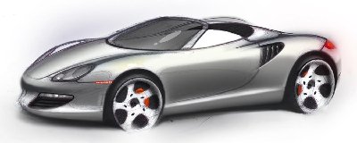

Talk of side intakes.....
This is what the new Boxster were intended to look like, but we could not make the air intakes work.
