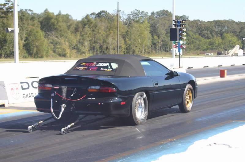

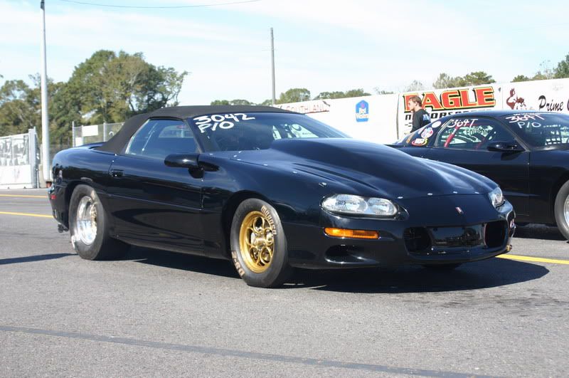

So what do you guy's think??
1999 Camaro SS convertible
359 CI, F2 Procharger, parachute and all of the rest of the normal bolt on's!!

Nice motor - how much is she pushing?

What's with the "learning" wheels on the back. My kid used to have a pair like that on his bicycle. :wink:

The car put down 1000rwhp @ only 7000rpm on our in house Mustang dyno , we spin the car up to 8500rpm. If you guy's are interested I have a lot more pic's that show the car going from start to finish. This is a full out, stock suspended race car. It used to be my daily summer cruiser.
Hell, if you guys put out a car with that kind of power, you'd need those wheels too!
Although, they'd have to have some kind of wing on it :wink:

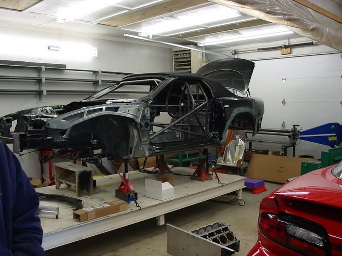

I looked at some of the build-pics ... some good work you did there ... guess it's no cruiser anymore ... :lol:

Little more info on the car:
1999 SS Camaro
359 cube engie
5.3 Liter race heads, 2.055 / 1.600 valaves, 340cfm @ .700"
Iron 6.0 liter block
Callies Race Master crank
Comp Cams solid roller cam.......very big!
F2 Procharger
Powerglide trans by Hutch's
Chance bolt together converter, 6100rpm stall
Custom mild steel headers by PFE, 1 7/8" to 2" to 2 1/8th with race merge collector and bullet mufflers
Custom KTS Race Cars fab 9" rear end, 3.90:1 progear
40 spline, gun drilled, lighten Moser axles
Custom fuel & water cells
And the list goes on and on..........
The car weighs......2850lbs, ready to race, minus driver!
We have only had it to the trackonce this year, maiden voyage. Had some belt issues, along with head gasket issues.........36lbs of boost does that. We will be back at the track on January 28th with it. We are hoping to be the first 7 second LS1 powered car. If we don't get it there, she will be all over the bottom 8's.
Thanks guy's, here's more pic's!!
