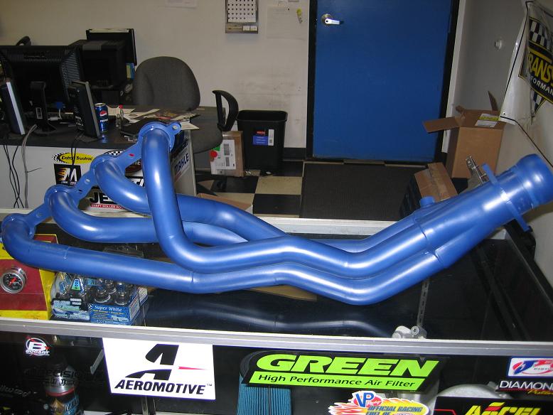

Some more pictures....Also it has full Pedders suspension with new shocks/struts/bushings and I added 2006 GTO brakes (bigger rotor and caliper compared to 04) with powerslot rotors.
