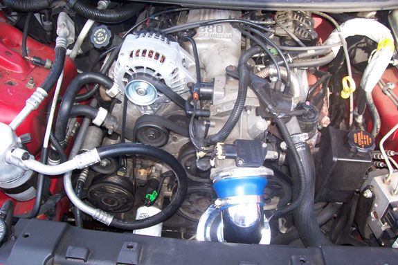

PostPosted: Fri Jun 15, 2007 9:50 am
From 1995 to 1998 the L36 engine had a angled down throttle body, after that they switched over to an straight throttle body, so i guess the pipe connecting the airbox to the throttle body is curved differently.
PostPosted: Fri Jun 15, 2007 10:02 am
The first one is a 1998, the second one a 1999
(just ignore that crappy intake on the first picture ;) )
File comment: 1998 - angled
File comment: 1999 - straight
