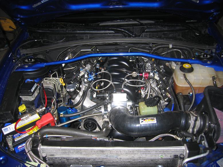

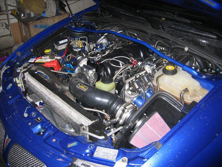

416 CI L92 w/150 shot plate kit. Just needs to be tuned now... Work done by Speed INC of Chicago.
Some of the components:
L92 Block
4" Forged Compstar Crankshaft
Compstar Connecting Rods
Diamond Pistons
Clevite Bearings
JP Performance Double Row Timing Chain
SLP Heavy Duty Oil Pump
Manley 8.1 Pushrods
ETP 245 Heads (62cc chambers)
Comp Cam 235/240 .646/.609 112
Ported FAST 90mm Intake and 90mm TB
Kooks 1 7/8th LT Headers w/cats
3" Stainless Works Exhaust
4L65E LVL 5 FLT Transmission w/ Circle D triple disc torque converter
NX 150 N20 Plate Kit w/progressive controller and all the gadgets
Standalone Fuel Cell for N20 (race gas)
BMR HD Stubs and CV Axles
BMR Subframe Connectors

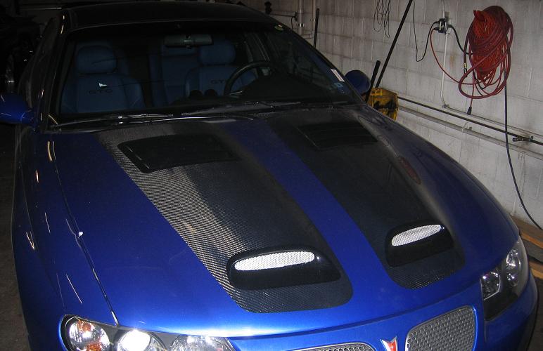

CF Banshee Hood
CF Rear Bumper Insert
JHP Lip Spoiler
Built for DD duty and to go to the track 1-2 times a month during drag season.
In the future I'm going to get a 2 piece HD Driveshaft and also probably get the rear wheel wells tubbed once I get back from Iraq (leave in February again).
I'm dying right now because the car is in Chicago and I am in Arizona, hoping to have it shipped to me by the end of the month.

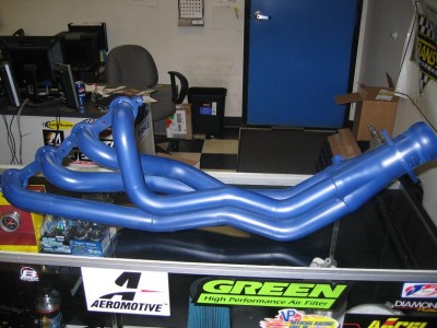

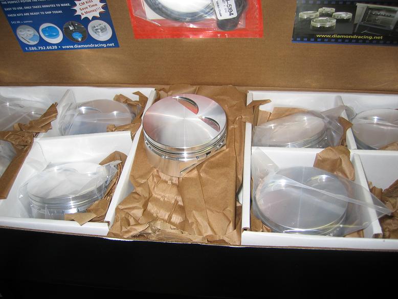

Some more pictures....Also it has full Pedders suspension with new shocks/struts/bushings and I added 2006 GTO brakes (bigger rotor and caliper compared to 04) with powerslot rotors.

Nice! Speed Inc does some good work . How much power do you expect to make?

Should be real close to 500rwhp N/A.

Final numbers ended up 490rwhp/472rwtq.
DD cam 235/240

Pretty big cam for a DD ...

235/240 is a pretty small cam for a 416CI motor. Most run a 240/250 as a mild cam while a big cam is considered a 250/260.
