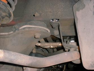

You may have just saved yourself quite a bit of problems by greasong them.
The bushings on my 93 binded up and caused the brackets to actually crack out a chunk of the frame.
So yeah, good advice 8)

PostPosted: Tue Jul 24, 2007 8:52 pm
Ouch!
PostPosted: Wed Jul 25, 2007 5:55 am
Yup well on the ole chevelles they used to rip out the linkage brackets on the ends which is really crappy.
