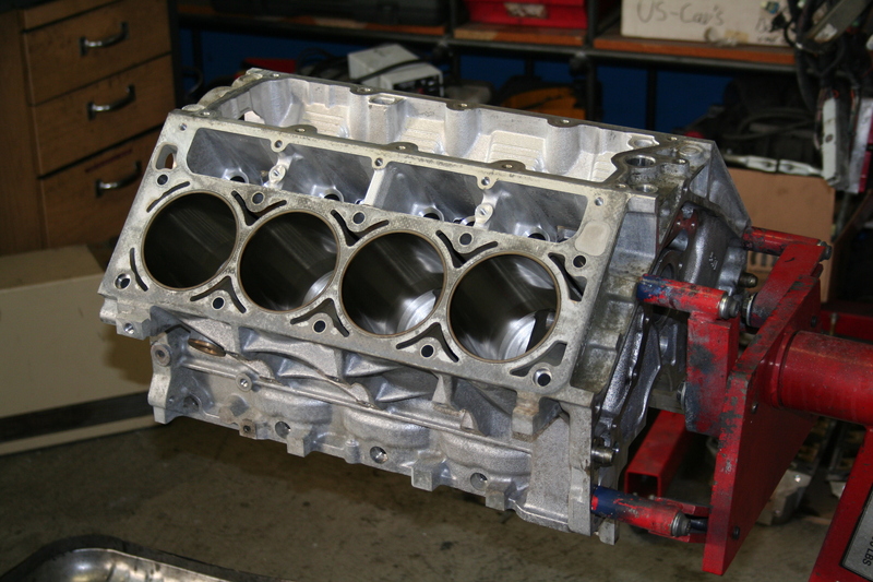

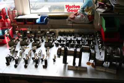

Btw, what other motors would you be able to do? I don't have anybody in particular, but I've been letting people know about the tuning, and some might have older motors than LT/LS series ... also, what motors do you do for Ford folks?
Btw, any word on the dyno cost yet?
Oh, the current state of my motor will hopefully change in time ... see below ;)
WOW!! Thems alotta partses.
