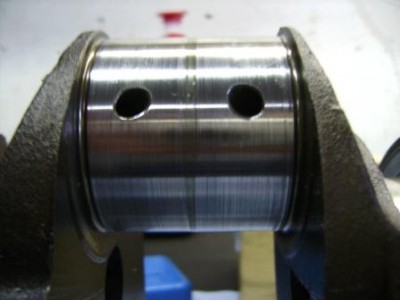

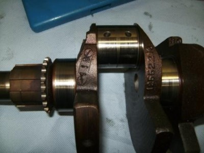

Hi Finally got time to measure the Crank again and make some pictures. I had a file with the measurements, and i finally found it. But i checked them again anyways and they are still correct. The Main Barings are not ok. but the Connecting Rod Bearings are right on the limit of the Gm book.
Main Bearings should be 64.993-65.007 service limit is 64.993
My worst is 64.986
So a little over the limit, need oversize bearings ! .007 mm!
The Connecting Rod bearings should be 53.318-53.338 service Limit is 53.308
MY worst is 53.310
So they are almost OK! + .002 mm !
Lunati and lots of other Company have over size main bearings.
The scoring is not too bad.
Ill try to up load some pictures now
The reason i dont need it is ! I got a good used one and i am buying a stroker kit !
So it just a paper weight to me ! :shock:
