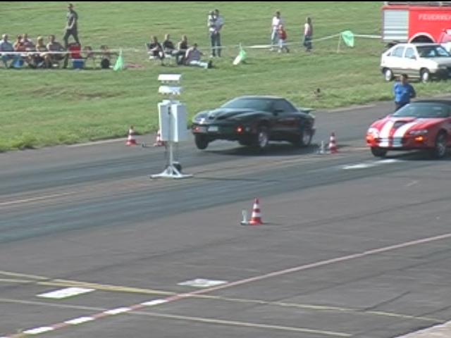

Do not even waste your money. I would say the comp XR 224/228 581/588 on a 114. very good street manners and stupid power. That was my 1st cam ran 11.7 on motor.
