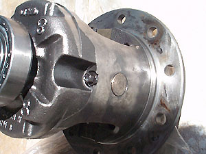

Rotate the carrier until you see the 5/16" hex head spider gear shaft retaining screw clear the rear axle housing. Remove the 5/16" hex head screw and gently slide out the shaft from the posi carrier. See the photo below:
The axles slide into the carrier s side gears and are held in place by C-clips. In order to remove the C-clips press each tire/axle towards the center of the car. This will allow you to see the C-clips on the end of the axle shaft and gain access to them. Depending on the posi you may have a S pring or a 4 small coil springs in there.
If it is a a torsen style it may have a paddle plate with another retaining screw to hold it in that you will have to remove.
The object is to push the axles in and remove the c-clips.
Its really quite simple just time consuming
