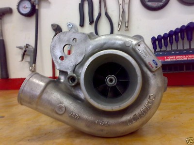

My newest acquistion for the car. Hopefully it gets me the air flow I need.
Jeejee I couldn't find a map for this, would you happen to know where I could find one?

what exhaust housing does it have ?
.63 or .48 ?
i should have some maps of those, but could not locate them off hand
:cry:
a .63 should be able to supply air for around 380-400hp
does it have a 360 thrust bearing ? because anything above 1-1.2bar will kill it otherwise pretty quick

I believe it is a .48 housing. The turbocharger is being shipped right now. If it has a 270deg journal bearing , I'll upgrade if possible to a ballbearing chra from garrett. Right now I just want to get all the bits and pieces together for it so I can procede forward.

I see on the turbine housing the number M4 and then hidden is AR0-63. Does that mean anything for housing side?
I googled the part number ontag that is on the compressor and it comes up with Garrett TB3403 ( For Ford Escort Cosworth.
