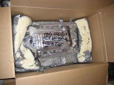

Autobahnz06gt,,,, so to be blown Callaway Magnasun.

Hey is that a blower for the Mondeo?

yep, that is the new Ford blower, stole from the SVT department, haha,
I am picking that piece up Thursday from Frankfurt.

maggies are nice :D i met the CEO at duttweiler's shop when he was running his 750HP ls series engine with a new blower on the dyno.
was quite impressive to see and what a enormous power at low revs too :shock:

is that the new SS/Corvette setup in that pic?
