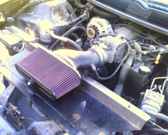

From 1995 to 1998 the L36 engine had a angled down throttle body, after that they switched over to an straight throttle body, so i guess the pipe connecting the airbox to the throttle body is curved differently.
PostPosted: Fri Jun 15, 2007 10:02 am
The first one is a 1998, the second one a 1999
(just ignore that crappy intake on the first picture ;) )
File comment: 1998 - angled
File comment: 1999 - straight

thx for help. My one have the angled tb. Any ways to convert the K&N aitr intake to the 1998 ??
Or any other kits available? Which is the best air intake filter system for a 1998 3.8 V6 ???
 Post subject: Re: thx
PostPosted: Sat Jun 16, 2007 11:00 am
I think a conversion doesn't make sense as you would have to change the entire upper intake manifold, lots of money for nothing.
Simply get a whisper lid for a 1998 model...
( http://www.lmperformance.com/1618/13.html )
...and probably a SLP Cold Air Induction Package.
( http://www.lmperformance.com/741/13.html )
Sounds and works nice (no silencers, completely smooth lid!), picks up cold air, looks like stock and doesn't scream "Modified!!!" like the K&N kit does, so you can easily pass TÜV with it ( tried that already ;) ).
