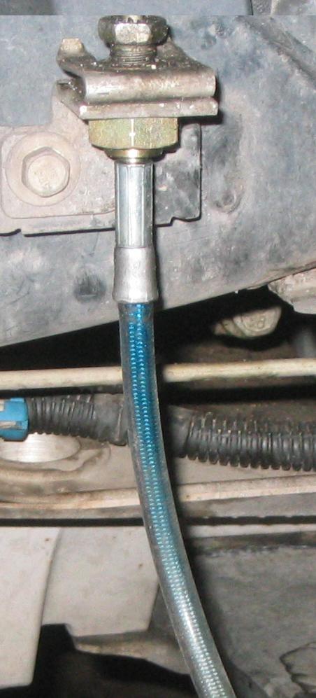

okay, WTF is going on here
brakes feel fine, no fluid is driping out of the line, how is the SS braid turning blue
PostPosted: Wed Jul 05, 2006 10:49 am
Is it the same blue color as the brake fluid?
PostPosted: Wed Jul 05, 2006 10:52 am
yep, ATE Superblue
there is a clear plastic cover over the SS lines, and everything is staying in it
PostPosted: Wed Jul 05, 2006 11:24 am
*gg* - so at least the outside isolation is still without any leaks ... guess you have a leak on the inside line somewhere ... I'd say up on top ...
PostPosted: Wed Jul 05, 2006 12:01 pm
You definitely got a leak.
PostPosted: Thu Jul 06, 2006 7:01 am
This is the response from LG and Wilwood. Guess I'll keep my eye on it and make sure it's not getting any worse.
Quote:
It looked funny to me, and I emailed Wilwood and asked them as I have no experience with this fluid and this is what I got back from them.
Quote:
I did notice the color, but wasn't sure if that was the problem. The Super Blue fluid from ATE is actually blue and has been known to stain brake components. My guess is that it's not seeping thru, it was spilled upon installation. If it's seeping thru, the whole line should be stained, and would need to be replaced for obvious reasons.
So if you are not having any issues with pedal feel or any signs of leaking then there should not be any problems with it, but yeah it looked strange to me as well.
