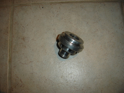

Checked the compressor bypass valve and the diaphram is ruptured. So while it was in boost it leaked pressure and at idle it had a vacuum leak at idle.
Has any seen a compressor bypass valve like the one in this picture . There are no markings on it and it is completely rebuildable.

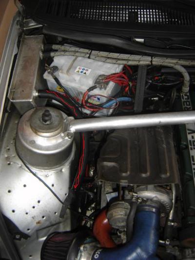

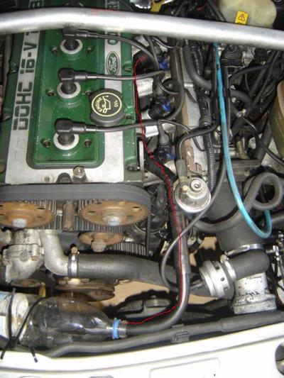

Hey JeeJee
Have any Idea where these hoses connect to ?
The first picture is a hose that comes from the intake manifold I believe . I colored it red for clarification . Yes that is a waterbottle that the hose is going into now.
The second picture has a hose coming from a catch and going nowhere.

PostPosted: Wed Apr 04, 2007 9:59 pm
the red hose from the intake manifold as you say actually comes from below the intake there is a hole that leads to the crankcase.
normally this then goes into a small seperator allso beneath the intake manifold
then it goes to the airfilter.
BUT with modified engines the crankcase pressure becomes a lot higher and as a result there will be blown a lot of oil into the airfilter
so then a hose will go from the small seperator to a large seperator ( the steel box in the passengerside of the engineroom)
along with 1 -2 hoses from the valvecover
so the hose that now is in the bottle will actually need to go to the steel large seperator (sec. picture)
but i can't see a vent to athmosphere at the top of the steel seperator you have.
that is ABSOLUTE nessesary !
without it you will blow all oil seals in the engine in notime..
can you make a better picture from the separator in the second picture ?
